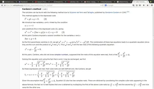

write $x^3 + 3x + 1 = a,$ so $x^3 + 3x + (1-a) = 0.$ There is exactly one real solution $x.$ Therefore Cardano's method will allow us to find this $x$ explicitly with real-valued square roots and cube roots. That is, we avoid https://en.wikipedia.org/wiki/Casus_irreducibilis regardless of the value of $a.$ https://en.wikipedia.org/wiki/Cubic_function#Cardano.27s_method
