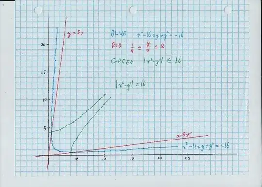

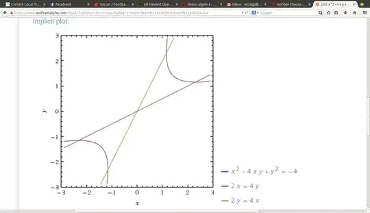

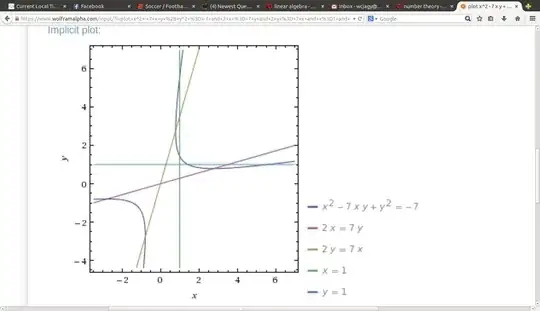

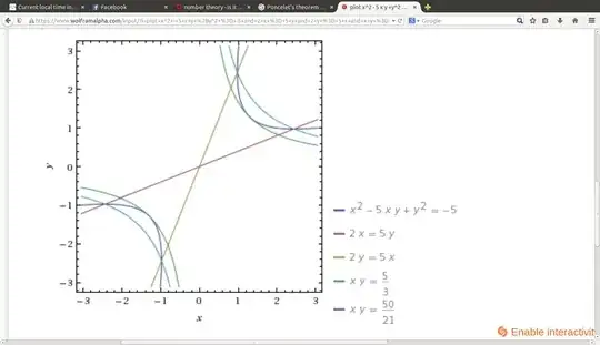

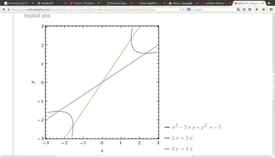

I made a bunch of pictures which show how the argument goes for this problem. All concepts are shown in detail at Is it true that $f(x,y)=\frac{x^2+y^2}{xy-t}$ has only finitely many distinct positive integer values with $x$, $y$ positive integers?
On the other hand, this one is fairly easy and may help people. The Vieta Jumping argument says that, if there are any integer points $(x,y)$ in the hyperbola $$x^2 - q xy + y^2 = -q,$$ with integers $x,y,q > 0,$ then there are integer points that also satisfy $$ 2x \leq qy $$ $$ 2y \leq qx. $$ This viewpoint comes from A. Hurwitz (1907) and clarifies these Vieta Jumping problems nicely.
For now, I am just going to put several diagrams for increasing $q.$ There are no integer points in the central arc for $q=3,4.$ For $q=5$ there are some, namely $(2,1)$ and $(1,2).$ For $q \geq 6$ we see that the central arc has only a very short arc with both $1 \leq x,y \leq 2,$ outside of which there are two fairly long arcs (but still inside the Hurwitz lines) that have either $0 < x < 1$ or $0 < y < 1.$ As a result, there are no integer points satisfying the Hurwitz conditions (which are just the inequalities we get after Vieta Jumping) and therefore no integer points at all.
