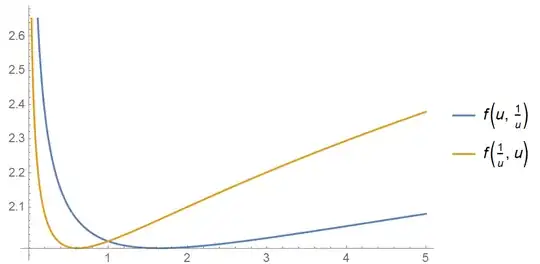

I had a lucky guess (which remains to be proven), that the minimum of the function:
$$f(u,v)=u^{1/4}+v^{1/3}+\sqrt{\frac{1-uv}{u+v+2uv}}$$
is the same as the miminum of the following two functions:
$$f(u,1/u), \qquad f(1/v,v)$$
Which is confirmed by Mathematica output:
Note that this is the same as $uv=1$, which makes the third term exactly zero.
Minimization leads to the following for the first case:
$$u=\left(\frac{4}{3}\right)^{12/7}, \qquad v= \left(\frac{3}{4}\right)^{12/7}$$
Which makes the function:
$$f_{\text{min}}=\left(\frac{4}{3}\right)^{3/7}+\left(\frac{3}{4}\right)^{4/7}=\left(\frac{3}{4}\right)^{4/7} \left(1+\frac{4}{3} \right)=\frac{7}{12} \cdot2^{\frac67} \cdot 3^{\frac47} $$

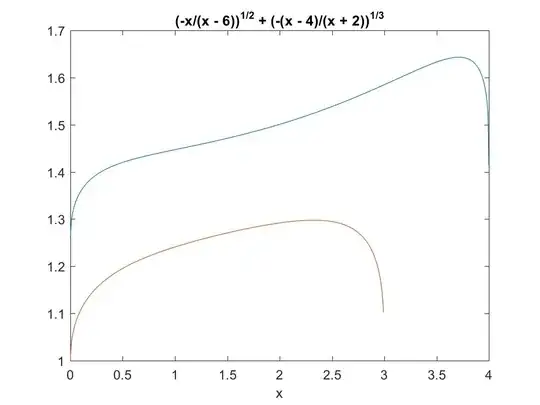

From the discussion above, for any given $(a,b,c)$, let us choose the two argument functions (for the sake of the discussion, say, $f$ and $g$)) which have the smallest values (which are less than 1). Then we have $a+b = s \le 4$. For if $s >4$, these were not the two argument functions which have the smallest values, as $c <2$.
Now for any fixed $s\le 4$, we have that $\sqrt{f(a)}+\sqrt[3]{g(s-a)}$ takes the smallest value (infimum) at the boundary, i.e. either at $a=0$ or $a = s$, i.e. $b=0$ (likewise for a pair of other roots). It takes a lengthy discussion on values and derivatives to show this. Notably, the statement is false for some $s>4$.
The following picture illustrates the situation for $s = 3$ (lower curve) and $s = 4$ (upper curve):
enter image description here This means that, for a lower limit, one variable out of $(a,b,c)$ will be zero, and the corresponding root will be zero. All the dicussions above did not specify yet which one. So we are left with the three cases of choosing that variable.
