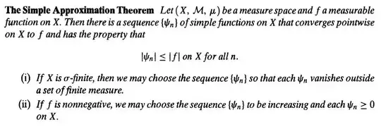

I have another idea that is to use Simple Approximation Theorem to prove.
Here is the Simple Approximation Theorem: enter image description here
update
In general it is not true that functions in $L^p(\mathbb{R})$ vanish outside of a set of finite measure(counterexample see @Ant 's comment). However it is true that simple functions in $L^p(\mathbb{R})$ vanish outside of a set of finite measure.

  • What is your "Simple Approximation theorem"? – HarshCurious May 07 '16 at 18:21
