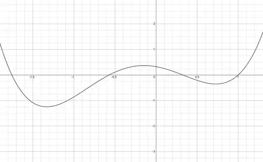

Here is a graphical representation of the fourth degree polynomial:
$$y= x^4 + x^3 -1.7548776662316001862 x^2 - 0.5698402909809427985 x + 0.32471795721254298472$$
with roots: $x_1 = 1$ , $x_2 = -1.7548776662316001862...$ , $x_3 = -0.5698402909809427985...$ $x_4=0.32471795721254298472...$.
