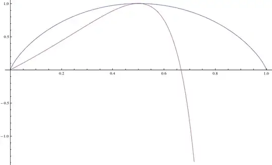

I am looking for the most concise and elegant proof of the following inequality: $$ h(x) \geq 1- \left(1-\frac{x}{1-x}\right)^2, \qquad \forall x\in(0,1) $$ where $h(x) = x \log_2\frac{1}{x}+(1-x) \log_2\frac{1}{1-x}$ is the binary entropy function. Below is a graph of the two functions.
Of course, an option would be to differentiate $1,2,\dots,k$ times, and study the function this way — it may very well work, but is not only computationally cumbersome, it also feels utterly inelegant. (For my purposes, I could go this way, but I'd rather not.)
I am looking for a clever or neat argument involving concavity, Taylor expansion around $1/2$, or anything — an approach that would qualify as "proof from the Book."

    A possible idea would be to show $h(x) \geq f(x) \geq g(x)$ for all $x\in (0,1)$, where $g(x) = 1-\left(\frac{x}{1-x}\right)^2$ and the "middle function" $f$ is defined by $f(x) = 1-4\left(\frac{1}{2}-x\right)^2$. The advantage is that $h,f$ are both symmetric around $1/2$ and concave, so that may be useful; and $f,g$ are both rational functions, with also may make things simpler. Yet, it still does not feel very clean... – Clement C. Apr 29 '16 at 14:10
    Your graph suggests that $g(x)\geq g(1-x)$ for $x\in[0,\frac{1}{2}]$, and a simple computation confirms that : $g(x)-g(1-x)=\left(\frac{x}{1-x}-\frac{1-x}{x}\right) \left(2-\frac{x}{1-x}-\frac{1-x}{x}\right) $ and this will be $\geq 0$ by AM-GM. Since $h(1-x)=h(x)$, it suffices to show the inequality for $x\in[0,\frac{1}{2}]$. – Ewan Delanoy May 01 '16 at 17:59

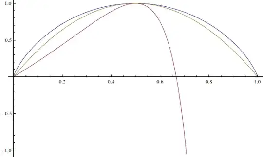

The Hermite interpolation polynomial for the function $h(x)$ at points $0$, $\frac{1}{2}$,$\frac{1}{2}$ $1$ is $P(x)= 4 x(1-x)$. The remainder formula is $$f(x) - P(x) = \frac{f^{(4)}(\xi_x)x(x-\frac{1}{2})^2 (x-1)}{4!}$$ where $\xi_x$ is an intermediate point between $0$, $\frac{1}{2}$, $1$ and $x$ ( inside their convex hull). Now we only need to that on $(0,1)$ the fourth derivative of $f$ is negative. Indeed, we have $$f^{(4)}(x) = -\frac{2}{\log 2}\left (\frac{1}{x^3} + \frac{1}{(1-x)^3} \right)$$ We conclude that for $x\in (0,1)$, $x\ne \frac{1}{2}$ we have $$h(x) > 4 x(1-x)$$
Now it is enough to check that for $x\in (0,1)$, $x\ne \frac{1}{2}$ we have $$4x(1-x) > 1- (1- \frac{x}{1-x})^2$$ Indeed, their difference equals $\frac{x(2-x)(2x-1)^2}{(1-x)^2}>0$.
Note: this stronger inequality we proved is mentioned in the Wikipedia article on binary entropy function that was quoted by the OP. Worth thinking about the higher estimate.
$\bf{Added:}$ Using the Taylor expansion at $x=\frac{1}{2}$ we get $$h(x) = 1 - \frac{2}{\log 2} (x-\frac{1}{2})^2 - c_4 (x-\frac{1}{2})^2 - \cdots $$ while $$4x(1-x) = 1 - 4 (x-\frac{1}{2})^2$$ So we can see the inequality from the Taylor series expansion. Moreover, we can get an exponent $\alpha$ so that $$4x(1-x)^{\alpha} -h(x)$$ has a zero second derivative. $\alpha$ is such that $\alpha \cdot 4 = \frac{2}{\log 2}$, that is, $\alpha = \frac{1}{\log 4}$. It is not hard to check that all the coefficients of the Taylor expansion of $$(4x(1-x))^{\frac{1}{\log 4}}- h(x)$$ are positive, and so we get the upper estimate mentioned in Wikipedia.
The plots of the functions $4x(1-x)$, $h(x)$, $(4x(1-x))^{\frac{1}{\log 4}}$.
$\bf{Added:}$ Numerics suggest that we have the stronger inequality $(4x(1-x))^{0.9}< h(x)$ on $(0,1)$, $x\ne \frac{1}{2}$. Note that $\frac{1}{\log 4} = 0.721\ldots$.
