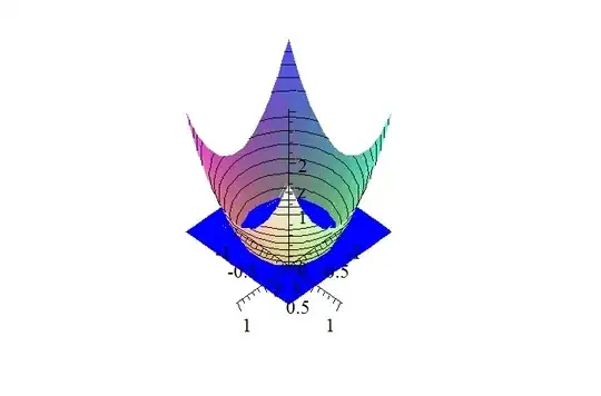

It is attained on the intersection of the surface $z=\frac{3}{2}\left( x^{2}+y^{2}\right) $ with the vertical cylinder $x^{2}+y^{2}=\frac{4}{9}$ or equivalently with the horizontal plane $z=\frac{2}{3}$.
enter image description here $$\text{Plane }z=\frac{2}{3} \text{(blue) and surface }z=\frac{3}{2}\left( x^{2}+y^{2}\right) $$
