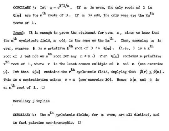

The equality $\mathbb{Q}(\zeta_m)=\mathbb{Q}(\zeta_n)$ holds if and only if (WLOG) $m$ is odd and $n=2m$.
The following is from Marcus's Number Fields, p.19:
