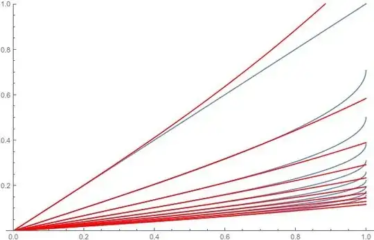

As mentioned in the comments, there is no way to simplify while maintaining the accurate relation. If approximately there could be convenient simplifications. First let me clarify the question a bit. Suppose $\arcsin(x) = \theta$, then $\sin(\theta) = x$, so what you try to achieve is if $\sin(\theta)$ is known, what's $\sin(\theta/n)$.
A straight forward attempt is do a Taylor expansion of $\arcsin(x)$, for large $n$ the sine function can be expanded around $0$ as well. If two terms are kept of the arcsine expansion: $$ \arcsin(x) = x + \frac{x^3}{6}+O(x^5) $$ Then $$ y = \sin \left(\frac{1}{n} (x + \frac{x^3}{6}) \right) \approx \frac{1}{n} (x + \frac{x^3}{6}) $$ Below is a figure (red is approximation above, blue is the accurate value), the approximation works well up to $x = 0.8$ for $n \geq 2$.
comparision
Taozi

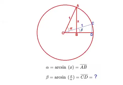

THIS ANSWER IS ADDRESSED TO BEGINNERS.
In the figure below you have an approximate representation of $\sin (x)$ and $\sin (\frac xn)$.
Your problem is to calculate the length of the segment $\overline {CD}$. Since you have $n( \frac xn)=x$, you can first find $\sin (nX)$ and then replace $X$ by $\frac xn$. The expression of $\sin (\frac xn)$ for each value of $n$, given in function of $\sin( x)$ is more and more complicated as it grows $n$. For example, in $$\sin (3x)=4\cos^2(x)\sin (x)-\sin (x)=3\sin (x)-4\sin^3(x)$$ replacing $x$ by $\frac x3$ you get $$\sin(x)=3\sin(\frac x3)-4\sin^3(\frac x3)$$ so you have the cubic equation to solve $$4t^3-3t+a=0$$ where $a=\sin (x)$.
Similarly, for $\sin(\frac x5)$, you have to solve the quintic $$16t^5-20t^3+5t-a=0$$ deduced of the formula $\sin (5x)=16\cos^4(x)\sin(x)-12\cos^2(x)\sin (x)+\sin (x)$.
In general for $\sin (\frac xn)$ you have to solve an equation of degree $n$.
