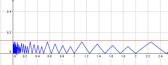

To illustrate what happens, I constructed a toy example with $\beta=2$ and $t=2$ and plotted the relative error (due to rounding) $$ \frac{|fl(x)-x|}{x}=\frac{|2^e\times1.ab-x|}{x} $$ where $e=\lfloor \log_2 x\rfloor$ and $1.ab$ is a binary number representing $x/2^e$ rounded off to two binary digits.
Here is the graph of $fl(x)$ along with the horizontal line $y=\tfrac12\times 2^{-2}=0.125$:
We can see that the relative rounding error is maximal just a little after $0.5,1$ and $2$. In fact the pattern repeats since each time the exponent $e$ is shifted by one, the number $x/2^e$ runs through the exact same values $[1,2)$ again.
The maximal relative error can be found exactly where $x=2^e\times (1+\tfrac12 \times 2^{-2})$ or simplified $x=2^e\times 1.125$. In base $2$ the number $1.125$ is $1.001_2$ and is being rounded up to $1.01_2=1.25$. Therefore $$ \frac{|fl(1.125)-1.125|}{x}=\frac{|2^0\times1.25-1.125|}{1.125}=\frac{0.125}{1.125} $$ which is just slightly less than $0.125$.
So why is this rounding unit (upper bound on the relative error) only half the size of the machine precision? Well, you can actually see it on the graph between $1$ and $2$: the distance between the valleys (zero error/full precision) is $2^{-2}=0.25$ which is rougly twice the height of the maximal error top.
