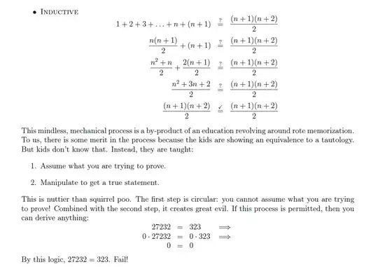

Edit: In case I wasn't clear, here's a snippet of the lecture note.

    I don't get it. They both seem "good". In neither case do you accidentally assume $P(n+1)$. – goblin GONE Apr 08 '16 at 06:27
  • @goblin ; I've attached a snippet of the lecture note, hope it clears things up. – Maxis Jaisi Apr 08 '16 at 06:38
  • As long as all the statements are if and only if, everything is fine. The example you attached, $27232=323$ doesn't work because its a one way implication. –  Apr 08 '16 at 06:40

As I understand it, an invalid 'proof' involves an inferential strategy like:
$$P(n+1) \Rightarrow \cdots \Rightarrow \cdots \Rightarrow \mathrm{True}$$
which fails to establish the truth of $P(n+1)$.
A genuine proof looks more like
$$P(n+1) \Leftrightarrow \cdots \Leftrightarrow \cdots \Leftrightarrow \mathrm{True}$$
or
$$\mathrm{True} \Rightarrow \cdots \Rightarrow \cdots \Rightarrow P(n+1),$$
both of which succesfully establish the truth of $P(n+1)$. But this has nothing to do with proof by induction per se; its just basic logic.
goblin GONE
  • 69,385
  • I think the author is probably concerned about the invalid proof $P(n+1)\Rightarrow True$, but as long as you word [Bad?] correctly, then your really saying $P(n+1)\Leftrightarrow True$. –  Apr 08 '16 at 06:34
  • @user43687, yep, I agree completely. High school students (and teachers!) frequently write almost-correct solutions to problems for exactly this reason. They assume $3x+1=4$ and deduce $x=1$, but never pause to check that from $x=1$, you can deduce $3x+1=4$. If pressed, the teachers sometimes appeal to a high powered theorem asserting that $3x+1=4$ has precisely one solution, so that the converse follows immediately. My only issue with this is they expect the students to intuitively understand and know this high-powered theorem, and never bother to explain it or make their logic explicit. – goblin GONE Apr 08 '16 at 06:37
    (cont.) No wonder math seems so illogical! The way its taught, it is illogical. – goblin GONE Apr 08 '16 at 06:38
We are not assuming what we want to prove. The key point is that the "bad" author uses equivalence transforms to arrive at a true (based on the induction hypothesis) statement. It is just unfortunate that the fact that the transforms are equivalence transforms ("$\iff$ instead of - insufficiently and wrongly - just "$\implies$") is hidden from the reader in the word "re-written". So, while not wrong per se, the "bad" proof at least suffers from the potential to stylistic improvement in this respect.
Apart from this, the author has a point: Whenever you apply transforms to arrive at a true statement from the statement you want to prove, there is always the risk that somewhere deep inside you accidentally have a step that is only $\implies$ and not $\iff$ ... So while this direction may be very well suitable for discovering a proof on scratch paper, I'd still recommend to rewrite everything into the "good" order for a published proof.
