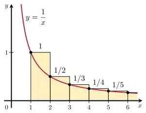

Consider the sum $$H_n = \sum_{k=1}^n\frac{1}{k}$$ for $n=1,2,\ldots$. These are called the harmonic numbers. You are interested in $\lim_{n\to\infty}H_n$.
Notice that $H_3 = 1 +\frac{1}{2}+\frac{1}{3}$ is just the area of the shaded region between $x=1$ and $x=4$ in the figure below. For any $n$ the area of the shaded region will be larger than the corresponding area under the red line, the graph of $y = \frac{1}{x}$. This implies $$\begin{eqnarray*} H_n &=& \sum_{k=1}^n \frac{1}{k} \\ &>& \int_1^{n+1} \frac{dx}{x} \\ &>& \int_1^n \frac{dx}{x}. \end{eqnarray*}$$ Similarly, an upper bound can be found, $$\begin{eqnarray*} H_n &<& 1+\int_{2}^{n+1} \frac{dx}{x-1} \\ &=& 1+ \int_1^n \frac{dx}{x}. \end{eqnarray*}$$ Therefore, $$\log n < H_n < \log n + 1.$$ The lower bound implies $\lim_{n\to\infty}H_n = \infty$, that is, the sum grows without bound. In addition we find $H_n \sim \log n \, (n\to\infty)$, that is, $H_n$ behaves like $\log n$ for large $n$.
Your intuition that $H_n$ grows very slowly is spot on. Roughly, if we want the sum to be some number $N$ we need about $e^N$ terms. For example, $H_n \simeq 185{}^\dagger$ for $n \simeq e^{185}$. That is, we need as many terms as there are atoms in the universe for the sum to reach $185$.
Illustration of the integral test in calculus. Integral_Test.svg, By Jim Belk (User:Jim.belk) (Own work) [Public domain], via Wikimedia Commons
Figure 1. Illustration of the integral test in calculus by Jim Belk.
${}^\dagger$ Actually, $H_n \simeq 185.577$.
