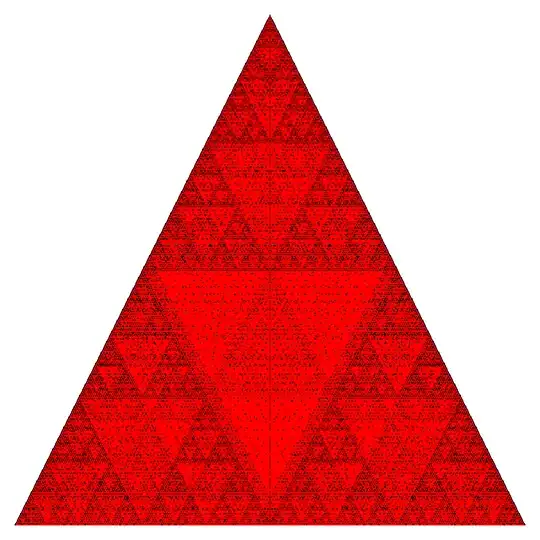

A similar question was asked here for the more general case of when $\frac{1}{n}\binom{n}{k}$ is an integer, generating some very nice graphics, and some special cases were mentioned such as when $\gcd(n,k)=1$, however that will never be the case in the special case I ask about (since $\gcd(2n,n)=n\neq 1$ for all $n>1$). Indeed, when looking at the lovely image made by @BrunoJoyal, one notices a black line down the center of the image, which would correspond to those positions I am interested in.
triangle
Wolfram gives us the beginnings of a sequence $1,6,15,28,42,45,66,77,91,\dots$ With the exception of $42$ and $77$ these numbers are the first hexagonal numbers, but that pattern breaks with $120$ not being in the sequence.

    Interesting question! I'm happy to find my image here :) – Bruno Joyal Mar 17 '16 at 20:32
  • You can also see black lines in the image corresponding to $n$ dividing $\binom{3n}{n}$. – 2'5 9'2 Mar 20 '16 at 07:03
