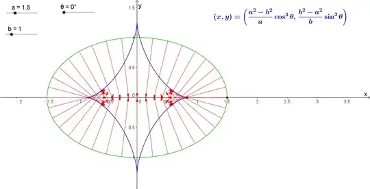

If we try reducing the dimension from three (ellipsoid) to two (ellipse) and setting $a=1.5,b=1$, the unit normal vectors (inward) won't pointing on the straight line (i.e. the degenerate ellipse $\displaystyle \frac{x^{2}}{0.5^{2}}+\frac{y^{2}}{0^{2}}=1$).
And also the discrepancy of another case
Ng Chung Tak
  • 19,693

  • @MPW See the cases of ellipse in my post – Ng Chung Tak Mar 08 '16 at 15:41
