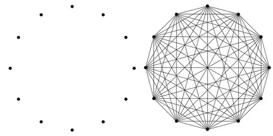

I was recently doing a homework problem that involved finding the number of lines used to connect a given number of points on a circle. Looking at it logically, I saw that that for the first point, there would be $n-1$ lines you could draw (where $n$ is the number of points on the circle) and the next point would have $n-2$ lines because you're not repeating the line between point $1$ and point $2$. It made sense that this would continue until point $n$, at which point there would be zero lines you can draw.
This meant that if you just add up all of those, you'd get the number.
For example, in the picture below there are $12$ points, so
$11+10+9+8+7+6+5+4+3+2+1 = 66$ lines.
Image of how the lines are connected
That's all fine, but the weird thing was, when I looked in the back of the book, the answer was given as $\binom{n}{2}$, which also equals $66$. What's the relationship? Why are the two equal?
  • From one point of view, your first paragraph could be regarded as answering your question. (But there's more to know about it than that.) $\qquad$ – Michael Hardy Mar 06 '16 at 21:03
    What software did you use to draw the illustrations? $\qquad$ – Michael Hardy Mar 06 '16 at 21:04
  • Duplicate: http://math.stackexchange.com/questions/50485/sum-of-n-consecutive-numbers. – Martín-Blas Pérez Pinilla Mar 06 '16 at 21:05
    Every line connects exactly two points. Therefore, the number of distinct lines is exactly the number of ways of choosing $2$ points - i.e. $n \choose 2$. – Mathmo123 Mar 06 '16 at 21:05
  • Shouldn't it be obvious that $\binom{n}{2}$ is the number of lines to connect $n$ points? Each line corresponds to a choice of two of the points. From that perspective it would seem to me that the first paragraph is simply a proof of the fact that $\binom{n}{2} = (n-1)+\cdots+1$... Also read Sudhadeep's link; it's my favorite proof by picture. – Dustan Levenstein Mar 07 '16 at 01:44
  • Ya, I've been thinking about it and it is sort of obvious –  Mar 07 '16 at 02:09
  • As @MichaelHardy asked earier, which software did you use for drawing this diagram? –  Mar 07 '16 at 08:20
  • I just got it from this article. –  Mar 07 '16 at 08:28

SBareS has provided you with a good answer. Here is a combinatorial proof.
There are $\binom{n}{2}$ subsets of $\{1, 2, 3, \ldots, n\}$ with two elements. Of these subsets, there are $k - 1$ subsets with largest element $k$, with $1 \leq k \leq n$. Hence, $$\sum_{k = 1}^{n} (k - 1) = \binom{n}{2}$$
In the problem you did, think of the vertices as numbered. You counted the diagonals in which the vertex with the smaller number was $k$, with $1 \leq k \leq 12$. That yields the sum $$\sum_{k = 1}^{12} (12 - k) = 11 + 10 + 9 + 8 + 7 + 6 + 5 + 4 + 3 + 2 + 1 + 0 = 66$$ Notice that $$\sum_{k = 1}^{n} (n - k) = \sum_{k = 1}^{n} (k - 1) = \binom{n}{2}$$ since the summands are the same, just written in the opposite order.
N. F. Taussig
  • 79,074
A way to get the result stated directly is to note that if you have $n$ vertices, to pick a diagonal is to select a pair of vertices, which means in all there are $\binom{n}{2}$ diagonals.
Another way is to pick each of the $n$ vertices, it participates in $n - 1$ diagonals connecting it to the other vertices, thus $n (n - 1)$ in all. But this counts each diagonal twice, once for each of its ends. Thus $n (n - 1) / 2 = \binom{n}{2}$
