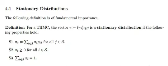

I'm currently trying to understand (intuitively) what a stationary distribution of a Markov Chain is? In our lecture notes, we're given the following definition:
def

  • To answer the problem they gave you, you need to show that each of $\pi_a,\pi_b, \pi_c$ satisfy all three conditions $S1,S2,S3$ to be a stationary distribution. – Mick A Mar 07 '16 at 00:08
