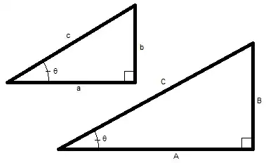

The origins of these functions lies in two theorems of plane geometry that the Greeks discovered long ago:
  • The sum of the angles of a triangle add up to $180^\circ$. (For the Greeks, this was "two right angles", but I'm translating into more modern terminology.)
  • If two triangles have all three angles the same size as corresponding angles on the other triangle, then they are similar. That is, the ratios of corresponding sides are all the same.
So, suppose you have two right triangles. Then these two triangles each already have angles that are the same size, namely the right angle. Now suppose that they happen to have another angle with common measure. Because the sums of the three angles in each triangle add up to $180^\circ$, the third angles of each must also be the same size. Thus right triangles only need to have one other angle the same to be similar.
Two similar right triangles
So ratios of corresponding sides of the two triangles above have to be the same: $$\frac aA = \frac bB = \frac cC$$
A little bit of algebra gives us $$\frac ac = \frac AC,\ \ \frac bc = \frac BC,\ \ \frac ba = \frac BA$$
Label the sides by their relation to the angle $\theta$:
We see that:
for any right triangle with one of its angles equal to $\theta$, no matter what size, the ratios of $\frac {\text{adjacent}}{\text{hypotenuse}}, \frac {\text{opposite}}{\text{hypotenuse}}, \frac {\text{opposite}}{\text{adjacent}}$ are the same as for all the other such right triangles.
Thus $\theta$ completely defines these three ratios. For this reason, we give them the special names cosine, sine, and tangent.
$$\begin{align}\cos \theta &= \frac {\text{adjacent}}{\text{hypotenuse}}\\ \sin \theta &= \frac {\text{opposite}}{\text{hypotenuse}}\\ \tan \theta &= \frac {\text{opposite}}{\text{adjacent}}\end{align}$$

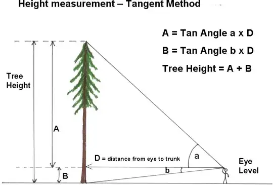

So, what is the point? Because sometimes (indeed, very commonly), you can't directly measure a distance that you want to know. See that tree outside? Want to know how tall it is? If it is a big tree, directly measuring its height is a very difficult proposition.
(Picture borrowed from http://www.monumentaltrees.com/en/content/measuringheight)
But if you can locate a point directly under it's tallest height, then measure the horizontal distance to some point far enough away to see the top. From that point, measure the angle your line of sight makes with the horizontal. This forms a right triangle, with the height of the tree as the opposite side, the distance you measured along the ground as the adjacent side, and the angle you measured as $\theta$. So go look up the tangent of your angle, and multiply:
$$\text{opposite} = \text{adjacent} \times \tan \theta$$
and now you know the height, without having to measure it directly. Of course, this is a simple example. In real life examples, the math is a little harder, but variants of this method allow you measure all sorts of distances where you can't get "directly under its highest point". The entire science of surveying is based on this.
