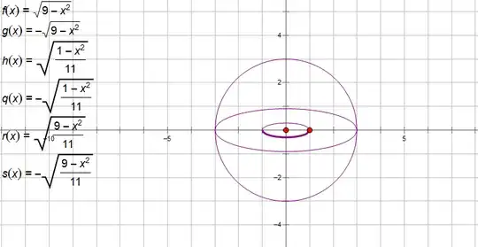

The original ellipse is congruent with the ellipse whose equation is $x^2+11y^2=1$. And all the ellipse which is similar to it has the equation form:$x^2+11y^2=\lambda$ Make it and $x^2+y^2=9$ as a equation group and solve it: $ x = \sqrt \frac{99-\lambda}{10} or -\sqrt \frac{99-\lambda}{10}, y = \sqrt \frac{\lambda -9}{10} or - \sqrt \frac{\lambda -9}{10}$.That means when $ 9<=\lambda <= 99$, the ellipse has intersection points with circle.
Therefore, when $\lambda = 9$ the ellipse tangent with the circle. The words are so abstract possibly. Here is the picture helping you understand them.
Therefore the minimal distance becomes distance between the long axis vertexes. Since one of the long vertexes of $x^2+11y^2=1$ is (-1,0) and one of the long vertexes of $x^2+11y^2=9$ is (-3,0).
Hence, the answer should be 2.
