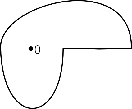

There is a pitfall which seems easy to forget, so I think it is worth adding some clarity. This text is not an answer, but a problem with an intuitive proof.
Below is an image of a bounded set in $\mathbb{R}^2$ (of course, the set is simply the inside of my curve), which I must admit is not convex, where scaling from the origin does not result in a ball (or at least not homeomorphically). In this case, the set is star-shaped, but not from any point. I drew it so that the origin is a center for the star-shaping, but only just. You can see that the "distance function" is either not a function or not continuous.
If you want to prove this question by scaling the boundary, please resolve my issue. I would try this:
Assume that the distance function, when defined as the supremum of all distances to the boundary in some direction (making it a function), has an incontinuity. Draw an $\varepsilon$-ball around the origin, prove that there is a point in that ball which is not a center for star-shapedness of the set, contradicting convexity.
problem

  • Oh I do believe the theorem holds, but if your "scaling" proof also holds for star-shaped sets in general, then your proof must have shortcomings. – akkkk Jul 04 '12 at 14:06
