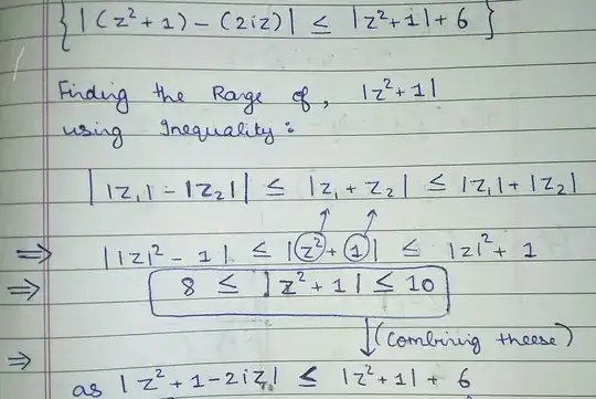

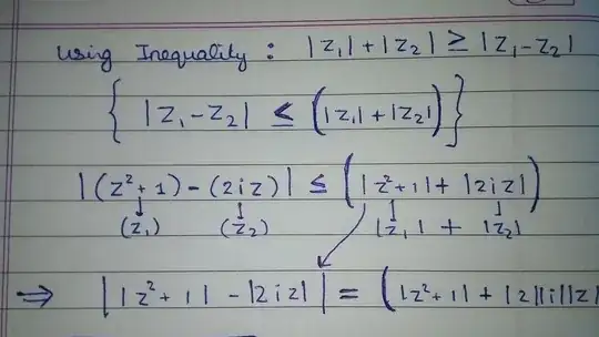

I am posting this as an answer in form of images because Images are not supported in the comments. Image 1 Image 2 Now so basically as pointed out in the comments even though we have determined the range of $|z^2+1|$ and know that its Maximum value is $10$ still we can't determine the maximum/minimum value of$|z^2-2iz+1|$...
So even though putting this (10)in the equation $$|z^2-2iz+1|\le 10+6 $$ and again keeping (8) in the equation $$|z^2-2iz+1| \le 8+6$$... we can only say this much ..but then again by looking at these two equations
$$|z^2-2iz+1|\le 10+6$$ $$|z^2-2iz+1| \le 8+6$$
So after looking at this(the two simultaneous equations) I think we can definitely say that $|z^2-2iz+1|$ must be less than or equal to $14$ because say we have $|z^2-2iz+1|$ and we know it is less than $16$ but we also know it is less than $14$ and so theese two can be simultaneously true only in one situation... and so our final inequality is... $$|z^2-2iz+1| \le 14$$ so this indeed gives the right answer $14$ but as pointed out in the comments by Ashish ..this is not the right method in general and only works in some circumstances such as these...so I am not so sure about this method because its is not in general...

  • In line 6 you assert that the LHS and RHS attain their maximum values with the same $x$. This is incorrect. Also it turns out that $|z^2-2 i z+1|$ attains its max at $z=-3 i$ which is when $|z^2+1|$ is minimized. – DanielWainfleet Feb 07 '16 at 05:42
  • The error you've made is in the last line. If we take $|z^2 + 1 - 2iz|$ as $a$ and $|z+1|^2$ as $b$ (to make explanation easy). What you have is $a \le b + 6$ and $8 \le b \le 10$. Since the maximum possible value of $b$ is 10, you can say that $a \le 10 + 6$ for all values of $a$ and $b$. However, this in now way provides a lower bound for $a$. You might also argue that the minimum value of $b+6$ is $14$, so $a$ must always be $\le 14$, however, this is not true either (generally. For this question, it turns out to be), since $a$ and $b$ are both functions of $z$. – Ashish Gupta Feb 07 '16 at 09:08
