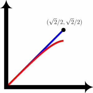

It is easy to show that $y=kx$ (a straight line through the origin, hence a great circle when mapped to the hemisphere) solves the second ODE (for the arc length functional) but not the first ODE (for the "energy" functional). The image below shows the incorrect solution for the "energy" functional ODE for the initial conditions ($y(0)=0$, $y'(0)=1$) in red and the correct solution in blue.
ODE solutions
The projection of a great circle whose plane is not perpendicular to the $xy$-plane into the $xy$-plane is an ellipse. Hence, there should also be solutions to the ODE of the form $(a^2+1)x^2 + 2abxy + (b^2+1)y^2=1$ (the plane of the great circle is $z=ax+by$). It is easy to check that these ellipses are indeed solutions of (2) but not (1) using a computer algebra system.
