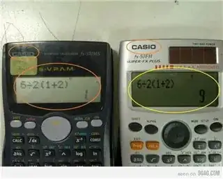

Please, look at the picture?
http://s16.radikal.ru/i190/1206/3b/7411739c6d9a.jpg
Which calculator shows true result and how to prove achieved result?

    correct answer is 9 – Aang Jun 28 '12 at 12:26
  • @avatar why you think so? can you proove your suggestion? – Tural Ali Jun 28 '12 at 12:28

    The Casio fx-570MS to the left is a model from 2005, whereas Casio fx-50FH was introduced in 2008, so I would go with the newer calculator on the right. Which, incidentally, has the right answer. – Per Erik Manne Jun 28 '12 at 13:08

  • One of the calculators may be a regular one and the other may be a scientific one. Unlike regular four-function calculators, scientific calculators follow order of operations. – Marvin May 10 '19 at 19:45

Despite every personal belief, a notation like $a/b(c+d)$ is ambiguous. At school I learned that this should be $$ \frac{a}{b}(c+d), $$ but even in research papers somebody could read $$ \frac{a}{b(c+d)}. $$

The reason why calculators are giving different results is because one is calculating,
$$\frac{6}{2\cdot(2+1)} = 1$$
while the other is calculating,
$$\frac{6}{2}\cdot(2+1) = 9$$
Depending on what you want to calculate, you could obtain different answers.

when two operations have same precedence, then the operations are done from left to right.So here, division is done first and then multiplication.This is just a convention.Without this, this expression is ambiguous.
