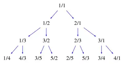

The Calkin-Wilf tree is an infinite undirected graph (tree) which is constructed as follows: starting from the root at $\frac{1}{1}$, each node $\frac{a}{b}$ has two children:
  • a left child $\frac{a}{a+b}$
  • a right child $\frac{a+b}{b}$
A picture of the Calkin-Wilf tree
This tree has the property that every rational appears in it exactly once, in lowest terms. I'm interested in ways to intuitively understand this fact.
