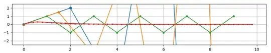

Numerical experiment
It is easy to perform the numerical experiment using any scripting or programming language. Here I set this up in a python script to compare the exact solution to the numerical solutions with the given step sizes
# set up the equation
def odesys(u): y,v = u; return np.array([ v, -3*v-2*y]);
# plot the exact solution
t = np.arange(0,10,0.1);
plt.plot(t, np.exp(-t)-np.exp(-2*t), color='lightgray', lw=4);
# Euler method for the 4 step sizes
for h in [ 2, 1.5, 1, 0.2]:
    t = np.arange(0,10,h);
    # initial conditions
    u = [ np.array([0.0,1.0]) ];
    # Perform Euler steps according to the time array
    for s in t[:-1]: u.append( u[-1]+h*odesys(u[-1]) );
    # plot the solution
    u = np.asarray(u);
    plt.plot(t, u[:,0], '-o', ms=2+2*h);
plt.ylim(-2.5,2.5); plt.grid(); plt.show()
solution plots
As can be seen, the solution for $h=1$ stays barely bounded, while $h=0.2$ slightly overshoots the exact solution, but correctly falls to zero.
