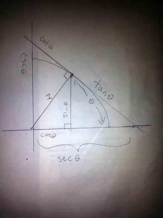

This isn't a formal proof, but its a nice geometrical relation that shows the identity holds.
Edit: I'd like to thank Yves Daoust for pointing a flaw in my reasoning.
The proper way to view this image as evidence that the identity holds is to compare areas. Thea area of a sector of the unit circle subtended by an angle $\theta$ is $\frac{1}{2}\theta$. The are the right triangle with side lengths $(1,\tan(\theta),\sec(\theta))$ is $\frac{1}{2} \tan(\theta)$. Visually it is clear that the area of the triangle exceeds the area of the sector, which suggests that $\tan(\theta)>\theta$.
- 12,691
I apologize for the sloppy image, I'll add a nicer one later when I have the tools available to make one at hand. – Spencer Jan 29 '16 at 08:08
Sorry but I don't see how this figure establishes a relation between $\theta$ and $\tan(\theta)$. – Jan 29 '16 at 08:15
$\theta$ is the labeled arc length along the circle. Compare this length with the line segment which has a length equal to $\tan(\theta)$. I'll try to edit the image to make this more clear. – Spencer Jan 29 '16 at 08:16
How do you compare a curve and a straight line ? I can agree for the chord, but not for the arc. (Changing the figure won't help.) – Jan 29 '16 at 08:17
@YvesDaoust, I think you edited your comment for clarification while I was typing my response; either that or I just missed your point on my first reading. I see what you're saying. I'm going to leave this up for now, but if I can't think of a way to convince you over the next couple of days I will delete the answer. – Spencer Jan 29 '16 at 08:32
@YvesDaoust, compare areas instead of arc lengths. The area of the sector subtended by the circle is $\theta/2$. The area of the triangle which has side lengths $(1,\tan(\theta),\sec(\theta))$ is $\tan(\theta)/2$. The area of the triangle is clearly larger than the area of the sector. – Spencer Jan 29 '16 at 08:37
I agree with that. I could'nt guess it from the figure. You can indeed make it more explicit. – Jan 29 '16 at 08:43
