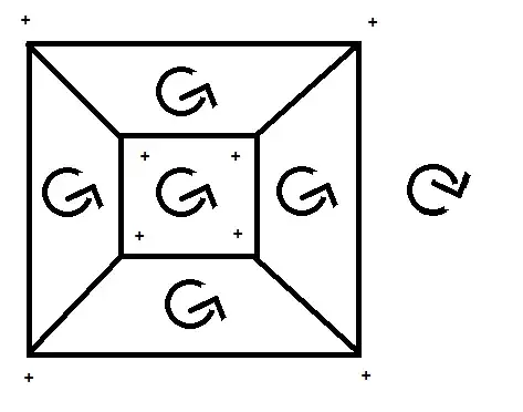

There are $2^{8}$ orientation. What is the usual one? How do these paths look like. An illustrative example is sought, because my brain starts to feel like a punctured sphere...

Does the usual orientation mean that we just assign a "$+$"-orientation, which should mean that we look at it like it is displayed? A "$-$" would flip the meaning of left and right. In this case the following would give the right number of left-hand cycle:
$\hskip1.5in$enter image description here

The picture that you have is completely right, I think, by the fact that you got the "usual orientation" induced from the orientation of the ambient $3$-dimensional space. Now you can walk around each face by turning always to the left - you get the $6$ left turning paths that the paper speaks about. To get the idea of what other orientation mean, please keep in mind that the paper defines orientation locally as some chosen cyclic order of edges around each vertex. Since you have $3$ edges, and $3$ cyclic shift of thereof, you have only $3!/3=2$ possible orientations around each vertex, and thus $2^8$ possible choices for the cube. Basically, this is what you say on your own: I'm sure you get everything correctly, just hesitate by some reason.
