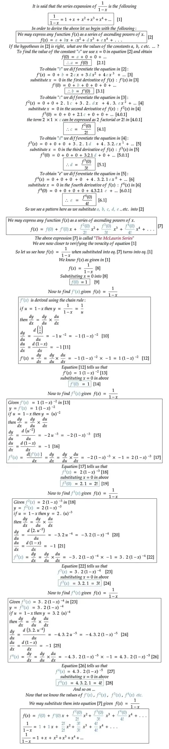

I wrote this answer up to reduce my own feelings of uncertainty about the expansion.
    @Especially Lime Thank you good Sir. I am not even sure what two characters you deleted to render the image. But thanks! – Arthur W Dec 04 '21 at 02:47
