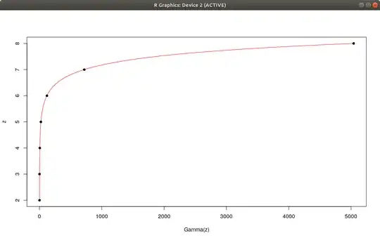

Here's an (improved) example in R, using the two step explicit scheme which appears to give the best agreement.
z0 <- 2;
zm <- 15;
g0 <- 1;
gm <- 5041;
psi <- function(z){if(z < zm){k <- floor(zm-z)}else{k <- 0};
                    return(log(z+k+1)-1/2/(z+k+1)-1/12/(z+k+1)^2-sum(1/(z+0:k)))};
h <- 1/20;
N <- floor((gm-g0)/h);
z <- 1:(N+1);
g <- g0+(0:N)*h;
z[1] <- z0;
z[2] <- z[1] + h/psi(z[1])/g[1];
z[2] <- z[1] + h/psi(z[2])/g[2];
n <- 2;
while (n <= N){n <- n+1;
                z[n] <- z[n-2] + 2*h/psi(z[n-1])/g[n-1];
       z[n] <- z[n-1] + h/psi(z[n])/g[n-1];
plot(g,z,type="l",col="red",xlab="Gamma(z)",ylab="z")
ge<-c(1,2,6,24,120,720,5040);
ze<-c(2,3,4,5,6,7,8);
points(ge,ze,pch=16)
z[which(g == 6)]
z[which(g == 24)]
z[which(g == 120)]
z[which(g == 720)]
z[which(g == 5040)]
The results are:
> z[which(g == 6)]
[1] 3.999231
> z[which(g == 24)]
[1] 5.001148
> z[which(g == 120)]
[1] 6.001462
> z[which(g == 720)]
[1] 7.00142
> z[which(g == 5040)]
[1] 8.001333
So the error is about $10^{-3}$.
Remark: Of course, I intentionally started with the most simple interval where gamma is monotone, so the inverse will be single-valued.
