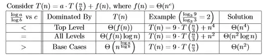

Using the Master Theorem, let $a=2, \, b=2, \, c= 3$. Since $\frac{\log_{2}\left(2\right)}{\log_{2}\left(2\right)}<3$ then $T(n) = \Theta(f(n))$. Therefore $T(n) = \Theta(n^3)$. enter image description here
  • This is an interesting way of looking at the problem that I wasn't familiar with. Thanks for the answer. – Greener Mar 13 '16 at 17:33
