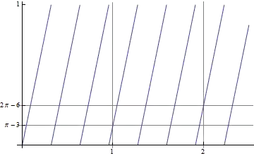

Also this is a plot of $d(n)$ for $x=\pi$:
Plot of d(n)
You see that for irrational x the height of the function at integers is not constant, nor periodic.
