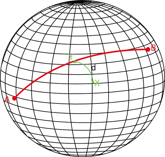

How would one calculate the interception point $Y$ with $\overleftrightarrow{XY}$ being the shortest distance of $X$ to $\overleftrightarrow{AB}$?
Cross track error coordinate
This answer to the question How to find the distance between a point and line joining two points on a sphere? describes how to calculate the distance, but not the coordinates.
What would be the most direct way to calculate the coordinates of interception point $Y$?

As a test case I have
  • $A (0,0)$
  • $B (90,0)$
  • $X (45,45)$
and get the following results my with my implementation
  • $3335847.799336763$ for $\overleftrightarrow{XY}$
  • $6086322.17407125$ for $\overleftrightarrow{AB}$
and thus $(54.735, 0) as coordinates for Y
Using $r * \cos (lat)$ the radius on the given latitude is $4504977.303$, thus $1/8$ of the circumference is $3538200.9$.
Shouldn't $Y$ be $(0, 45)$? Surely the shortest distance from $X (45, 45)$ to $\overleftrightarrow{AB}$ is the great circle on 45° latitude ? Thus the cross track -distance should be $3538200.9$. Am I lacking imagination in three-dimensions?
oschrenk
  • 251
I think the best way to do this would be to look at the sphere as a subset of 3-dimensional space, find the coordinates of A, B, and X in that 3-dimensional space (that's just converting spherical coordinates to Cartesian), and then you can (orthogonally) project everything onto the plane containing A, B, and X. A, B, and X project to themselves, of course, and the arc between A and B will project to the line between A and B, and the arc between X and Y will project to the line between X and Y. Therefore, Y will project to the orthogonal projection of X onto the line AB, and then from that you can just project back onto the sphere and convert that to latitude and longitude. It's somewhat indirect, but it avoids having to work with distances in spherical coordinates.
