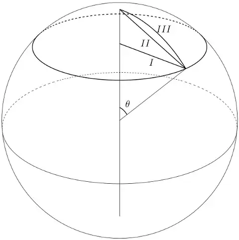

$\newcommand{\Reals}{\mathbf{R}}$Let $S$ be a sphere of radius $R$ in $\Reals^{3}$, and let $C$ be a circle on $S$ subtending an angle $\theta$ (with $0 < \theta < \pi$), as shown. There are at least three senses in which $C$ has a "radius" $r$. Each interpretation arises naturally in non-trivial settings.
Three notions of radius of a circle on a sphere
  • The Euclidean radius, with the circle's center in the Euclidean plane containing the circle ($I$ in the diagram). $r = R\sin\theta$; the circumference of $C$ is $2\pi r$.
  • The Euclidean radius, with the circle's center on the sphere ($II$ in the diagram). $r = 2R\sin(\theta/2)$; the area of the disk enclosed by $C$ is $\pi r^{2}$. (!!)
  • The arc of the sphere, with the circle's center on the sphere ($III$ in the diagram). $r = R\theta$ is the intrinsic radius, referring only to measurements in the sphere.
(Each of the last two is a double interpretation, since a circle on a sphere has two antipodal centers.)
The bottom line for "What is the radius of $C$?" is "It depends on context."
