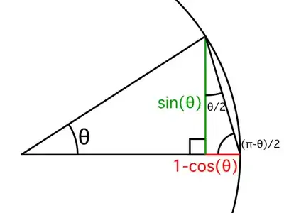

Proof without words: $\displaystyle\cot(\theta/2)=\frac{\color{green}{\sin(\theta)}}{\color{red}{1-\cos(\theta)}}$
$\hspace{3.5cm}$enter image description here
