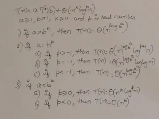

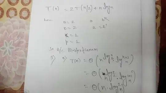

the given problem is best fit on master theorem
Naveen Kumar
- 59
1You just wrote the formulas, how is this an answer? And this problem isn't satisfied by the master theorem, so that's wrong too. – Mercury Oct 08 '20 at 16:29
