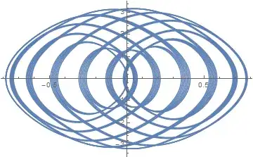

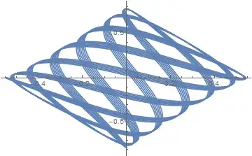

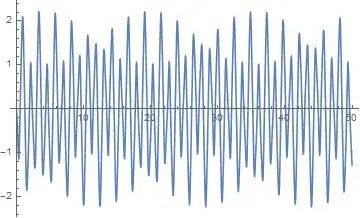

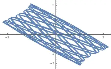

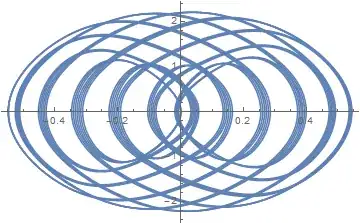

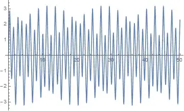

Of course, there are much cleaner approaches in code, but since you are using a spreadsheet, this gives everything in a form like you posted. Here are various plots for each of the parameters with each other for the initial conditions (recall that this system can exhibit chaotic behavior based on the initial conditions).

  • Nice. With the nearly periodic graphs it strongly indicates that a proper implementation will preserve energy and momentum, so there is no numerical/theoretical problem, and the question reduces, with high probability, to a problem with the implementation. – Lutz Lehmann Jan 01 '16 at 14:39
  • Many thanks for this. These are the exact equations I am using. I am working through it and hope to get the beautiful graphs you got. – Fionn O Ceallaigh Jan 02 '16 at 14:30
  • Many thanks to all who contributed on this. The consensus here was correct. The well laid procedure above was exactly what I was implementing in Excel, but seeing it written out so clearly helped me check against what I was doing in Excel. Variable's beautiful graphs and Lutzl's clear conclusions convinced me to again check my implementation. I found a couple of minor issues (missing brackets and a wrong energy calculation), and now everything works perfectly. Thank you. – Fionn O Ceallaigh Jan 05 '16 at 11:03
