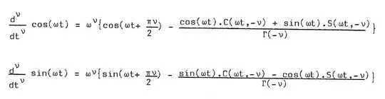

Hint :
The fractional derivative of the sinusoidal functions :
Copy from page 46, Eqs. (14-4) and (14-5) in the technical report "Use of ractional derivatives to express the properties of energy storage in electrical networks"(1982), no longer available but cited on page 13, ref.[9] in : https://fr.scribd.com/doc/71923015/The-Phasance-Concept
The special functions $S$ and $C$ are the "Generalized Fresnel Integrals", from : M.Abramowitz and I.A.Stegun, Handbook of Mathematical Functions, p.262, Dover Publ. N-Y. 9th print (1970).
In the case of the present question concerning fractional integration, $\nu=-\frac{1}{2}$ and $\omega=1$ $$\frac{d^{-1/2}}{dt^{-1/2}}\sin(t)=\sin(t-\frac{\pi}{4}) -\frac{1}{\sqrt{\pi}}\left( \sin(t)C(t,\frac{1}{2}) -\cos(t)S(t,\frac{1}{2})\right)$$ because $\Gamma(\frac{1}{2})=\sqrt{\pi}$
Note that, for large $t$ the generalized Fresnel integrals tend to $0$ and in steady state $\frac{d^{-1/2}}{dt^{-1/2}}\sin(t)\simeq\sin(t-\frac{\pi}{4})$
In the case of partial integration of order $\frac{1}{2}$ that is to say $\nu=-\frac{1}{2}$ a more direct approach is : $$\frac{1}{\Gamma(\frac{1}{2})} \int_0^t \frac{\sin(\omega \tau)} {(t-\tau)^{\frac{1}{2}} }d\tau = \sqrt{\frac{2}{\omega}}\left( \sin(\omega t)C\left( \sqrt{\frac{2\omega t}{\pi}} \right) - \cos(\omega t)S\left( \sqrt{\frac{2\omega t}{\pi}} \right) \right)$$ This is the same as above, thanks to the relationships between the Fresnel integrals and the generalized Fresnel integrals :
$C(x,\frac{1}{2})=\sqrt{2\pi}\left( \frac{1}{2}-C\left( \sqrt{\frac{2x}{\pi}} \right) \right)$ and $S(x,\frac{1}{2})=\sqrt{2\pi}\left( \frac{1}{2}-S\left( \sqrt{\frac{2x}{\pi}} \right) \right)$
In the field of electrotechnic, the particular case $\nu=\frac{1}{2}$ is related to the so-called Warbourg impedance and the related fractional derivative is : $$\frac{d^{1/2}}{dt^{1/2}}\sin(\omega t)=\sqrt{\omega} \left(\sin(\omega t+\frac{\pi}{4}) +\frac{1}{2\sqrt{\pi}}\left( \sin(t)C(\omega t,-\frac{1}{2}) -\cos(t)S(\omega t,-\frac{1}{2})\right)\right)$$ In steady state : $\frac{d^{1/2}}{dt^{1/2}}\sin(\omega t)\simeq \sqrt{\omega}\sin(\omega t+\frac{\pi}{4})$
