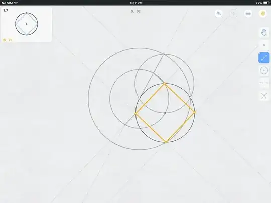

8-step process
  1. Take one step to create $\circ A$ with radius $AO$.
    • Take as point $E_1$ the 'left' resulting point of intersection.
    • Take as point $E_2$ the 'right' resulting point of intersection.
  2. Take one step to create $\circ P$ with radius $E_1O$.
  3. Take one step to create $\circ Q$ with radius $E_1E_2$.
    • Take as point $C$ the intersection point between circle $Q$ and circle $O$.
    • Take as point $F$ the intersection point between circle $Q$ and circle $A$.
  4. Take one step to create $\overleftrightarrow{E_1F}$.
    • Take as point $G_1$ the resulting 'top' intersection point with $\circ P$.
    • Take as point $G_2$ the resulting 'bottom' intersection point with $\circ P$.
  5. Take one step to create $\overleftrightarrow {AG_1}$ to effectively draw $\overline{AB}$.
    • Take as point $B$ the resulting intersection between said line and $\circ O$.
  6. Take one step to create $\overline{BC}$.
  7. Take one step to create $\overleftrightarrow{AG_2}$ to effectively draw $\overline{AD}$.
    • Take as point $D$ the resulting intersection between said line and $\circ O$.
  8. Take one step to create $\overline{CD}$.
    • This completes desired $\square ABCD$, albeit in one too many steps.

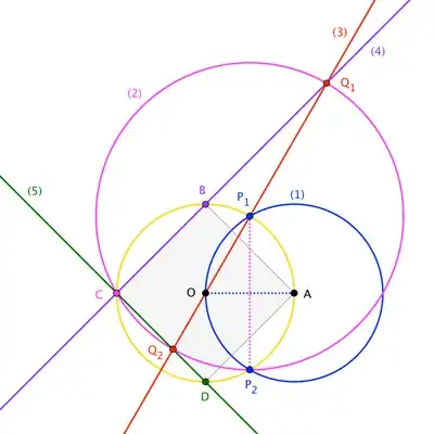

  1. Construct $\bigcirc A$ through $O$.
  • Let $P_1$ and $P_2$ be the points where $\bigcirc A$ meets $\bigcirc O$.
  1. Construct $\bigcirc P_1$ through $P_2$.
  • Let $C$ be the (other) point where $\bigcirc P_1$ meets $\bigcirc O$.
  1. Construct $\overleftrightarrow{OP_1}$.
  • Let $Q_1$ and $Q_2$ be the points where $\overleftrightarrow{OP_1}$ meets $\bigcirc P_1$.
  1. Construct $\overleftrightarrow{CQ_1}$.
  • Let $B$ be the point where $\overleftrightarrow{CQ_1}$ meets $\bigcirc O$.
  • Note that we have constructed $\overleftrightarrow{BC}$.
  1. Construct $\overleftrightarrow{CQ_2}$.
  • Let $D$ be the point where $\overleftrightarrow{CQ_2}$ meets $\bigcirc O$.
  • Note that we have constructed $\overleftrightarrow{CD}$.
  1. Construct $\overleftrightarrow{AB}$.
  2. Construct $\overleftrightarrow{AD}$.
Square $\square ABCD$, with constructed edge-lines, is inscribed in $\bigcirc O$. (Proof that the quadrilateral is, in fact, a square, is left as an exercise to the reader.)
Edit. Having been asked to elaborate on the square ...
  • As of Step 2, we know $\triangle P_1 P_2 C$ is equilateral and that $\overline{OA}$ is on the perpendicualr bisector of side $\overline{P_1 P_2}$. Therefore, $\overline{AC}$ is a diameter of $\bigcirc O$, and we have that $\angle ABC$ and $\angle ADC$ (for point $D$ constructed later) are right angles by Thales' Theorem.
  • As of Step 4, as observed by Jan and Tristan in the comments, $\overline{Q_1 Q_2}$ is a diameter of $\bigcirc{P_1}$, so $\angle Q_1 C Q_2$ is a right angle. Therefore, $\square ABCD$ is at least a rectangle.
  • Now, define $a := |\overline{OA}|$, so that $|\overline{P_1P_2}| = a\sqrt{3}$ and $|\overline{OQ_1}| = a( 1 + \sqrt{3})$. Since $\angle AOQ_1 = 60^\circ$, if we let $R$ be the foot of the perpendicular from $Q_1$ to $\overleftrightarrow{OA}$, then $|\overline{OR}| = \frac{a}{2}( 1 + \sqrt{3})$ and $$|\overline{Q_1R}| = \frac{a \sqrt{3}}{2}(1+\sqrt{3}) = \frac{a}{2}(3 + \sqrt{3}) = a + |\overline{OR}| = |\overline{CR}|$$ Thus, $\angle Q_1 C R = 45^\circ$ and we may conclude that $\square ABCD$ is a square. $\square$

  • $BCD$ is a right angle because $Q_1Q_2$ is a diameter of $\bigcirc P_1$, but can I get a seco hint for the rest of the proof? – John Dvorak Sep 16 '16 at 15:30
  • Note that $\triangle P_1 P_2 C$ is equilateral, and that $\overleftrightarrow{OP_1}$ bisects its angle at $P_1$ (and $\overleftrightarrow{OA}$ bisects its angle at $C$). Consider isosceles $\triangle P_1 CQ_1$ and calculate its angle at $C$. – Blue Sep 16 '16 at 16:27
  • Could you say a few words about the demonstration of why ABCD is a square ? Because that is what is the most interesting IMO. I can see why BCD is a square angle, but past this it's big mystery. – Tristan Apr 30 '17 at 13:08
  • @Tristan: See updated answer. – Blue Apr 30 '17 at 20:26
    @Blue: Small typo: Your explanation introduces $R$ but then uses it as $F$. – marcianx Sep 04 '17 at 06:49
  • @marcianx: Good eye. (I was probably transcribing from notes and changing notation on-the-fly.) I've made the fixes. – Blue Sep 04 '17 at 07:50
    I found another way to prove that ABCD is a square using only angles. I just thought that it's simpler to use angles instead of lengths :) Define the other intersection of line Q1 Q2 and circle O as E. C P1 P2 = 60 and Q2 P1 P2 = 30. Therefore C P1 Q2 = 30. C P1 Q2 is an isosceles triangle because of radius, so P1 Q2 C = O Q2 C = 75. COE is twice of C P1 E. COE = 60. O C Q2 = 180 - 75 - 60 = 45. O C Q2 = ACD = 45. We can prove that ABCD is a rectangle in the same way Blue did. – Eric Zhang Mar 17 '19 at 06:13

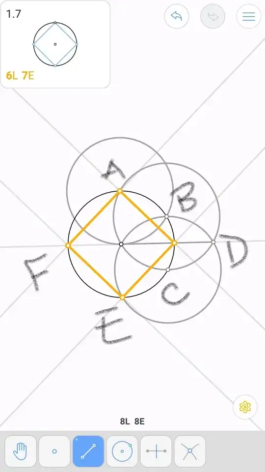

For what it's worth, the following solution also constructs an inscribed circle in seven elementary steps. Unfortunately, the original point is not on the square, so Euclidea does not recognize it, but it has a pleasing symmetry the other seven-step solution lacks. enter image description here
