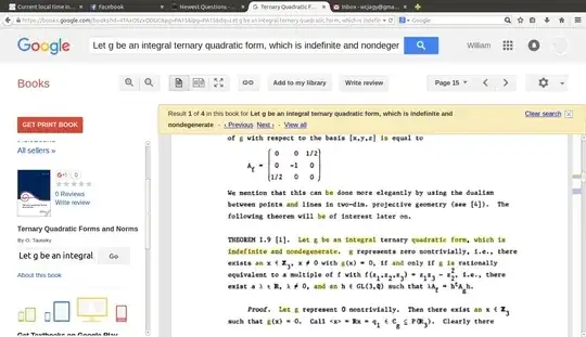

There is a viewpoint initiated in Fricke and Klein (1897), especially pages 507-508, and reported in Theorem I.9 on page 15 of PLESKEN. It is rigid as to dimensions: given an isotropic (over $\mathbb Q$ and therefore $\mathbb Z$) ternary quadratic form, it parametrizes all integer primitive solutions by one or more triples of binary quadratic forms.
The outcome is that every primitive integer solution to $$ 3x^2 + y^2 = 4 z^2 $$ can be written with $\gcd(u,v) = 1$ and $u \neq v \pmod 3$ as $$ x = u^2 + 2 u v, \; \; y = -u^2 + 2 u v + 2 v^2, \; \; z = u^2 + uv + v^2. $$ Here $z > 0,$ we may choose $\pm x$ but we do not get to choose the sign of $y.$
For your other question, you want $x/z = (s/t)^n$ for $n \geq 3.$ My first impression is that this means $$ u^2 + 2 u v = s^n, \; \; \; u^2 + u v + v^2 = t^n. $$ Either one can be accomplished alone, I don't see doing them simultaneously.
For the curious, the matrix identity guaranteed by the theorem in Plesken is $$ \left( \begin{array}{rrr} 1 & -1 & 1 \\ 2 & 2 & 1 \\ 0 & 2 & 1 \end{array} \right) \left( \begin{array}{rrr} 3 & 0 & 0 \\ 0 & 1 & 0 \\ 0 & 0 & -4 \end{array} \right) \left( \begin{array}{rrr} 1 & 2 & 0 \\ -1 & 2 & 2 \\ 1 & 1 & 1 \end{array} \right) = -12 \left( \begin{array}{rrr} 0 & 0 & \frac{1}{2} \\ 0 & -1 & 0 \\ \frac{1}{2} & 0 & 0 \end{array} \right) $$
