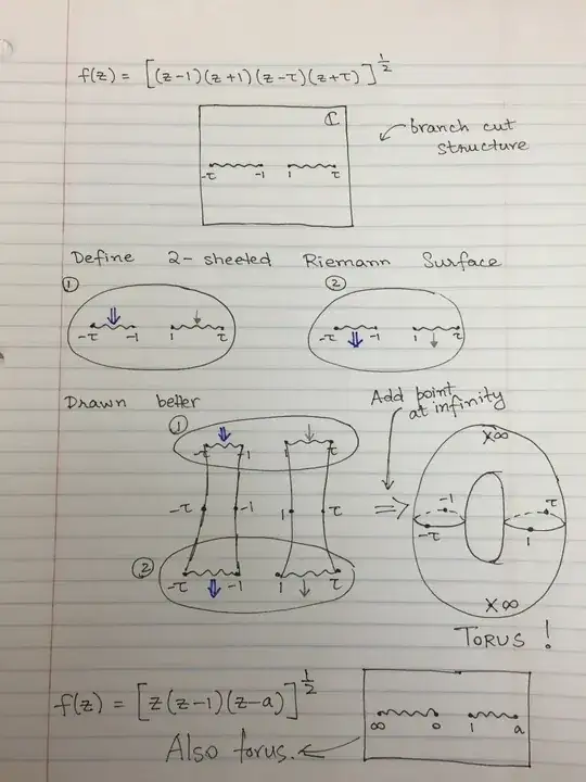

This should be connected to the Riemann surface $y^ 2 = z(z^2 -1)$. And we are computing a period of the Riemann surface.
