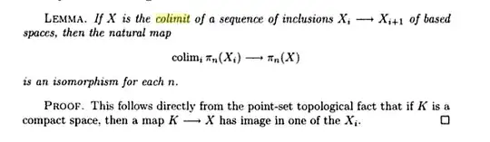

I found at the beginning of tom Dieck's Book the following (non proved) result
Suppose $X$ is the colimit of the sequence $$ X_1 \subset X_2 \subset X_3 \subset \cdots $$ Suppose points in $X_i$ are closed. Then each compact subset $K$ of $X$ is contained in some $X_k$
Now I really don't know how to prove this fact. The idea would be to find a suitable open cover to it and after taking a finite sub cover trying to claim that $K$ lies in one of the $X_k$. I'm able to do this reasoning in some more specific cases, where I've more control on how open subsets looks like, but in this full generality I don't see which open cover I can take.
My Attempt: The only idea or approach I'm able to cook up so far is to try use some kind of sequence of points $x_n \in K\cap X_n \setminus X_{n-1}$ which can be assumed to exist by absurd. Being $K$ compact, there must be an accumulation point $k\in K$. Clearly $k \in X_k$ (little abuse of notation here) and for every neighbourhood of $k$, there is a tail of this sequence entirely contained in it. Now everything seems to boil down to find the right nbhd to find the counterexample. It seems doable, but I don't have any idea on how to choose it, because the only open I have for sure are complements of points, but they seems a little bit coarse for what I want to do.
As a side note, May claims at page $67$ of his "Concise Course (revised)" that this result holds for any based spaces. The proof seems to use the above result without T1 assumption. How one can prove this result in such generalities? (no details where provided, only the rough idea.

    May is working in compactly generated weak Hausdorff spaces, which are $T_1$, so he doesn't need to make those assumptions explicit. –  Dec 21 '15 at 23:49
