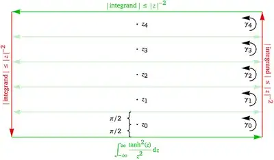

Solution 1. By the residue theorem, for any positive integer $k$, $$ \int_{\gamma_k} \frac{\tanh ^2(z)}{z^2} d z=2 \pi i \sum_{j=1}^k \operatorname{Res}\left(\frac{\tanh ^2(z)}{z^2}, z_j\right) $$ where $\gamma_k$ is the boundary of the rectangle $[-k, k] \times[0, i \pi k]$ oriented counter-clockwise and $z_j=$ $i \pi(j-1 / 2)$ for $j \in \mathbb{Z}$ are the poles of the integrand function. We note that along the two vertical sides of $\gamma_k$, $$ |\tanh ( \pm k+i y)|=\left|\frac{e^{ \pm k+i y}-e^{\mp k-i y}}{e^{ \pm k+i y}+e^{\mp k-i y}}\right| \leq \frac{e^k+e^{-k}}{e^k-e^{-k}} \leq \frac{1}{\tanh (k)} \leq \frac{1}{\tanh (1)}<2, $$ whereas, along the horizontal upper side, $|\tanh (x+i \pi k)|=|\tanh (x)|<1$. Hence, as $k \rightarrow+\infty$, $$ \left|\int_{\gamma_k \backslash[-k, k]} \frac{\tanh ^2(z)}{z^2} d z\right| \leq 2 \int_0^{\pi k} \frac{4}{k^2+y^2} d y+\int_{-k}^k \frac{1}{x^2+\pi^2 k^2} d x \leq \frac{8 \pi k}{k^2}+\frac{2 k}{\pi^2 k^2}=\frac{8 \pi^3+2}{\pi^2 k} \rightarrow 0 . $$
Moreover, the following series expansion at $z=z_j$ holds: as $w=z-z_j \rightarrow 0$, $$ \tanh (z)=\tanh \left(z_j+w\right)=\frac{1}{\tanh (w)}=\frac{1}{w+O\left(w^3\right)}=\frac{1}{w}+O(w) $$
Therefore $$ \frac{\tanh ^2(z)}{z^2}=\frac{\left(\frac{1}{w}+O(w)\right)^2}{\left(z_j+w\right)^2}=\frac{1}{z_j^2}\left(\frac{1}{w^2}+O(1)\right)\left(1-\frac{2 w}{z_j}+O\left(w^2\right)\right)=\frac{1}{z_j^2 w^2}-\frac{2}{z_j^3 w}+O(1) $$ which implies that $$ \operatorname{Res}\left(\frac{\tanh ^2(z)}{z^2}, z_j\right)=-\frac{2}{z_j^3}=-\frac{2 i}{\pi^3(j-1 / 2)^3}=-\frac{16 i}{\pi^3(2 j-1)^3} . $$
Finally, $$ \begin{aligned} \int_0^{\infty} \frac{\tanh ^2(x)}{x^2} d x & =\frac{1}{2} \lim _{k \rightarrow \infty} \int_{-k}^k \frac{\tanh ^2(x)}{x^2} d x=\frac{1}{2} \lim _{k \rightarrow \infty} \int_{\gamma_k} \frac{\tanh ^2(z)}{z^2} d z \\ & =\pi i \sum_{j=1}^{\infty} \operatorname{Res}\left(\frac{\tanh ^2(z)}{z^2}, z_j\right)=\pi i \sum_{j=1}^{\infty} \frac{-16 i}{\pi^3(2 j-1)^3}=\frac{16}{\pi^2} \cdot \frac{7 \zeta(3)}{8}=\frac{14 \zeta(3)}{\pi^2} . \end{aligned} $$
