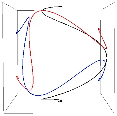

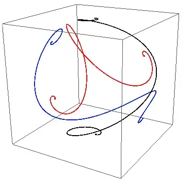

Updated answer to (2): Three non-intersecting $60^\circ$ loxodromes.
alt text
The axes are coplanar and inclined at $120^\circ$ to each other. This image shows that symmetry better:
alt text

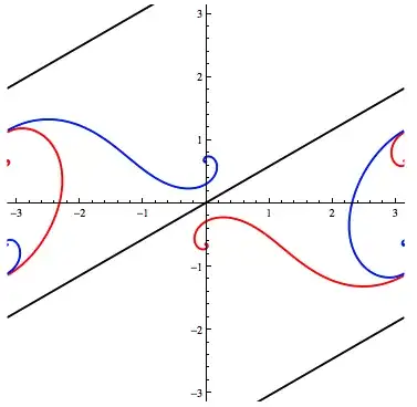

And here's the Mercator projection:
alt text

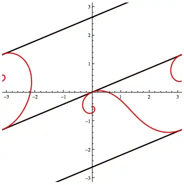

My approach was to plot one loxodrome such that its Mercator projection is a (black) line through the origin. Then, I tilted the spherical loxodrome "toward the camera"; that is, I rotated the sphere about the horizontal axis to get new, curvy (red) projections.
alt text

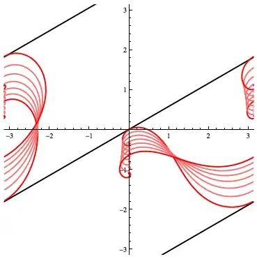

From tilt-angles $108^\circ$ to $143^\circ$, the "curve" lies between parts of the "line", indicating a range of red loxodromes that don't intersect the black one.
alt text

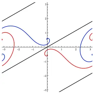

For a certain sub-range ($108^\circ$ to about $125^\circ$), a third (blue) non-intersecting loxodrome can be added by rotating the red one about the Mercator origin. Here's an image from the end of that range, where red and blue are tangent.
alt text

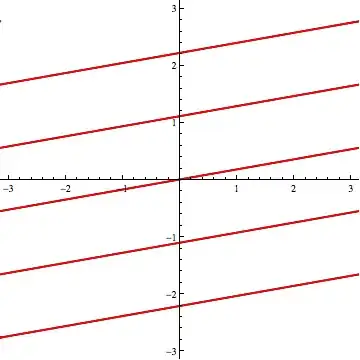

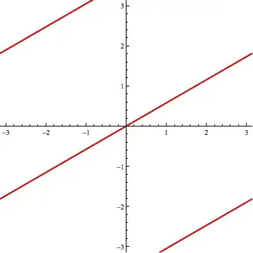

Not an answer, but an approach which might help.
Mercator projection is a map such that Loxodromes (corresponding to $0 \lt \varphi \lt 90^{\circ}$) get mapped to straight lines (and vice versa) and angles are preserved.
An image of the map:
alt text
So you would need to pick parallel lines from the mercator map.
The problem would be in choosing the correct antipodal points on the Mercator map and there could also be the problem of antipodal connecting lines possibly wrapping around the mercator map (which probably corresponds to your curvy $80^{\circ}$ loxodromes).
