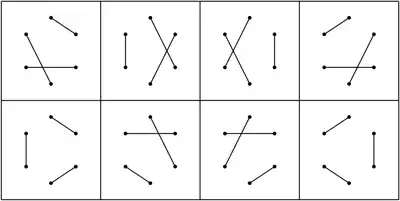

There are $\binom{n}{k}$ ways to choose $k$ opposites. For each of those choices, there are $(2n-2k-1)!!$ ways to form pairs with the $2n-2k$ left. Inclusion-Exclusion says that there are $$ \sum_{k=1}^n(-1)^{k-1}\binom{n}{k}(2n-2k-1)!! $$ pairings with at least one pair of opposites. Subtracting this from $(2n-1)!!$ gives $$ \bbox[5px,border:2px solid #C0A000]{\sum_{k=0}^n(-1)^k\binom{n}{k}(2n-2k-1)!!} $$ ways to pair without matching opposites. $$ \begin{array}{c|c} n&1&2&3&4&5&6&7&8&9\\\hline \text{pairings}&0&2&8&60&544&6040&79008&1190672&20314880 \end{array} $$ Here are the $8$ pairings for $n=3$:

  • What is your interpretation of the question ? Initially I though derangements, but "$2n$ people are sitting in a circle.." would seem to indicate that we need to work out pairings for any particular seating – true blue anil Dec 16 '15 at 07:15
  • @trueblueanil: I have added an image for $n=3$ which gives $8$ pairings. – robjohn Dec 16 '15 at 07:35
  • I understand your interpretation, you are simultaneously pairing all the people sitting in a circle, while I interpreted it as the sides and chords of a polygon excluding chords that pass through the center. – true blue anil Dec 16 '15 at 08:05
  • The question asks "How many ways can they form $n$ pairs if no two persons seated directly opposite each other can form a pair?" Each of the $8$ arrangements in the $n=3$ image above is "a way to form $3$ pairs if no two persons seated directly opposite each other can form a pair." – robjohn Dec 16 '15 at 08:12
