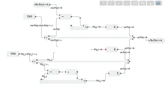

However, I get stuck trying to prove it using the actual logic connectors available in the tool. I'm not able to use the same approach in the second case of my case analysis (or at least I'm not sure how). This is my attempt:
Proof Image
If you look right in the middle of the diagram you'll see there are no connections (and a small red dot indicating an error). This approach doesn't seem to lead anywhere.
I'm using two instances of TND to do case analysis. The first case is as described above. But I don't know how to handle the second case, so I used a TND in the second case to generate two sub-cases: $P(y_{10}) \vee (P(y_{10}) \to \bot)$. The second case of this TND is again trivial, but the first case doesn't lead anywhere.
In the middle of the proof I have two facts $P(y_{10})$ and $(\forall x P(X)) \to \bot$. These two facts don't seem like they can lead to the conclusion.
I'm looking for a hint of an approach to try to solve this proof.
  • I'm wondering if there is a way to use the universal introduction rule to transfer P(y10) into $\forall x.P(x)$. No attempt I tried worked. If it did work, then we could prove $\bot$ and therefore prove the conclusion. – Michael Welch Dec 14 '15 at 22:52

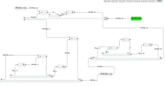

UPDATE: I finally finished the proof. The key to success was figuring out (with help) how to prove the identity $\neg \forall x P(x) \Rightarrow \exists x (\neg P(x))$. That identity was not built into the tool and can be a little tricky/cumbersome to prove from axioms. If you attempt the proof using the tool, learn how to create custom blocks like "proof by contradiction" and "case analysis". Otherwise the proof gets very messy. Here's the finished proof (still a little messy).
The blocks with the snowmen on them are "proof by contradiction". The block with baseball is case analysis.
Finished Proof
