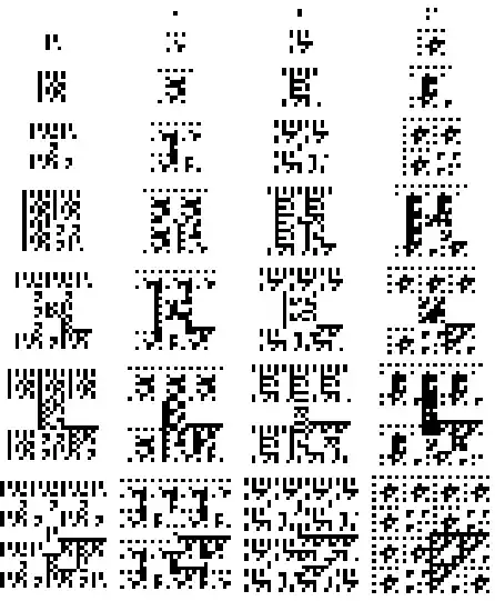

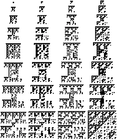

I fixed $p=3$ and initially tried to examine $a=0$ and $a=1$ by taking advantage of the corollary of Lucas' Theorem at the question you linked. Using black for "odd" and white for even, I got tables like the following for small $n$. $n=0$ is the top left table, $n=3$ is the top right one, $n=31$ is the bottom right one. Within a table, each row is a value of $k$ (starting from $0$) and each column is a value of $x$:
a=0($a=0$) a=1($a=1$)
We have nice patterns when $n$ is one less than a power of $2$, especially in the top left portion of the tables (when $x+k\le n$) and for $a=0$ where it looks especially like the Sierpinski triangle or the Walsh matrix. In fact, upon inspection, your expression is a little weird for $x+k>n$ since then $n-x$ dips below $k$, but $k-t$ goes up to $k$. From now on I'll focus only on $a=0$ for $x+k\le n$.

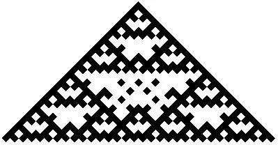

For example, rotating the picture for $n=31$ gives us n=31 rotated

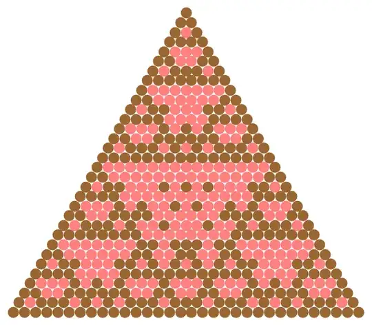

This looks nice and suggestive, but is perhaps a little wide. We can use hexagonally packed circles to view this a little better: n=31 with circles

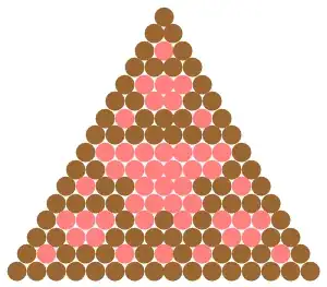

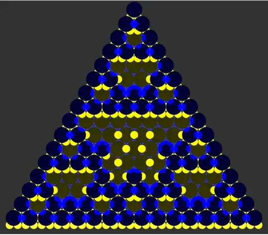

Now, in order to see a pattern, we can try to relate this to the $n=15$ case, which is precisely the top quarter of the whole image. n=15 I thought to focus on the seven isolated 1s (brown dots) that appeared in $n=31$ "in" the large gap of $n=15$. Using different colors and some layer work in Gimp. overlaps
This picture is a bit hard to analyze, but basically, when you align things just right, the isolated 1s that appear out of nowhere are at the centers of $\lozenge$s with 0s at the vertices of $n=15$. In fact, the centers of all $\lozenge$s (not just vertical ones) appear to follow a simple rule: it's a $1$ if there are zero or two $\lozenge$-vertices that are $1$, and and it's a $0$ otherwise. The small points that lie under a large point (so that they're not the centers of a $\lozenge$) share the same value.

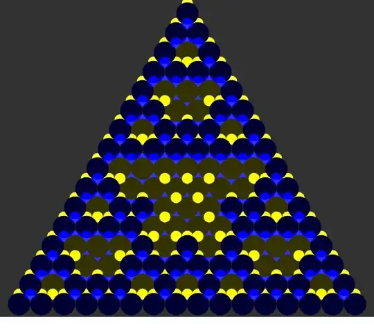

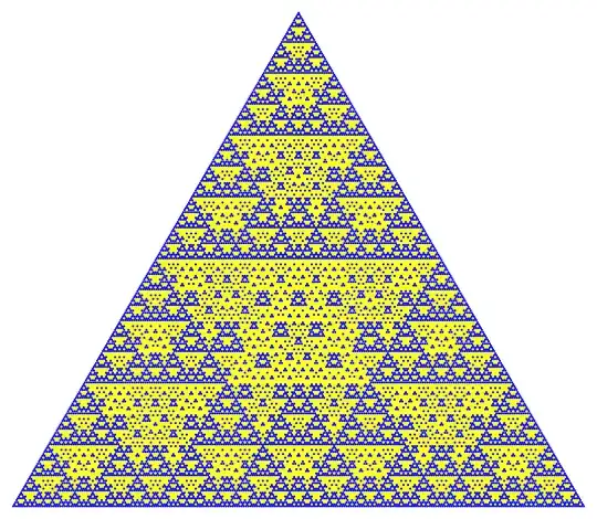

Here's a picture of $n=255$: blue-yellow 255
