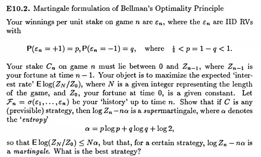

From David Williams' Probability with Martingales
Related question: Deducing an optimal gambling strategy (using martingales).
What I tried:

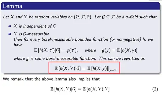

For no 3, no idea. Any hints? I think it has something to do with a stopping time. Might we have to use the ff lemma (red box):
Update 1 decade later: It's called freezing lemma I guess
$\mathbb{E}(\varphi(X, Y) | \mathcal{G}) = \mathbb{E}(\varphi(X, Y))$ What's the name for this proposition? Or alternatively what's happening?

Here is the solution to the questions.
Note that $Z_n = Z_{n-1} + \epsilon_n C_n$. We have $$\begin{align}\mathrm{E}\left[\log Z_n - \log Z_{n-1}\mid\mathcal{F}_{n-1}\right] &= \mathrm{E}\left[\log \left(1+\epsilon_n C_n/Z_{n-1}\right)\mid\mathcal{F}_{n-1}\right] \\ &= p\log\left(1+\frac{C_n}{Z_{n-1}}\right)+q\log\left(1-\frac{C_n}{Z_{n-1}}\right)\end{align}.$$ Consider $f(x) = p\log(1+x)+q\log(1-x)$. It reaches its maximum $\alpha$ at $x = p-q$. Therefore $$\mathrm{E}\left[{\log Z_n - \log Z_{n-1}}\mid{\mathcal{F}_{n-1}}\right] \le \alpha,$$ and so $\log Z_n - n\alpha$ is a supermartingale and it is a martingale if $C_n = (p-q)Z_{n-1}$ for all $n$. The best strategy hence is to follow $C_n = (p-q)Z_{n-1}$.
BCLC
  • 14,197
Zilin J.
  • 4,310
