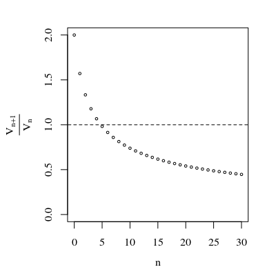

Decreasing size of integrand
Comparison with cylinders and extrusion: We could see this summation as a sort of extrusion but with a decreasing radius. If, instead, the radius is kept the same then we would extrude a cylinder and the volume (=surface times height) gets multiplied by two.
But instead of the cylinder, the radius scales like $\sqrt{1-x^2}$ and the volume will be multiplied with a factor that is less than 2. How much exactly is determined by the integral $\int_{-1}^1 (\sqrt{1-x^2})^{n-1} dx$ which is the area under the curves as shown in the below image:
$\quad\quad\quad$integrand
The integrand term $(\sqrt{1-x^2})^{n-1}$ will decrease for higher $n$ and the multiplication factor of the volume when making the (n+1)-ball out of n-balls is decreasing.
$\quad\quad\quad\quad\quad\quad\quad\quad$decrease of V_n+1 over V_n
