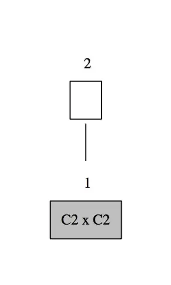

you will see that your semigroup has two $\mathscr{D}$-classes and hence two ideals. If you have the Semigroups package, then you can also do:
Splash(DotDClasses(T));
and obtain the following picture of the $\mathscr{D}$-classes and their partial order:
D-class diagram
You can also see that your semigroups is a copy of the direct product of the cyclic group of order 2 with itself, with an additional non-regular element on the top. The ideals are: the whole semigroup, and the group $C_2\times C_2$.
