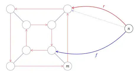

Clearly (2) will be violated in any diagram that is constructed by adding new node, $n$, to the diagram for a group $G$ by one-way arrows for each of the generators in $G$, since it provides no way to reach $n$ from any other nodes, so that paths starting at $n$ (only) cannot be reversed. This will be the case regardless of what nodes in $G$ each of the arrows from $n$ lead to. For example, starting with $G=D_4$:
But, while this diagram satisfies rules (1) and (4), doesn't it also violate (3) because, for example, $r^4=e$ and (starting from $n$) $r^4=r^{-1}$ even though $r^{-1}\neq e$?
EDIT: As discussed below, this figure does not, in fact, violate (3): the $r^{-1}$ mentioned above (the one starting at $n$) does not exist. Also, it does matter where the arrows from $n$ are connected: they must be connected to $G$ in a way that follows $G$'s rules. In the diagram above, for example, if the dotted path had been chosen for $f$ instead of the one indicated, the diagram would violate (3). Rule (3) will always be satisfied in a diagram where the connections from the added node replicate outgoing connections from a node in $G$ (here $m$).
The answer provided in the book's key focuses on the fact that (2) requires that any diagram
...cannot have two arrows of the same type pointing to the same destination from two different sources.
However, while this is certainly a property of (all?) diagrams (including the one above) that violate (2), it is not sufficient to violate (2), and can result in the violation of other rules instead. For example simply "rewiring" one of the cyclic actions in $D_4$ so that it points "to the same destination from two different sources" can produce a diagram that satisfies, (2) but violates (3):
The example offered in the key, violates not only (2), but (3) and (4) as well:
Is it possible to construct a diagram that satisfies rules (1), (3), and (4) while violating (2)?

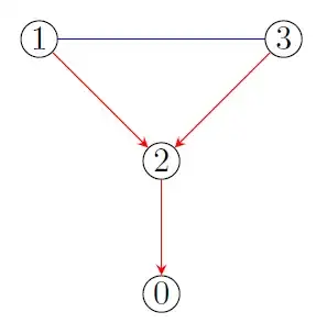

Edit: To construct such a diagram, we can consider the multiplication table of $\mathbb{Z}_n$ for any $n>1$. (Considering $\mathbb{Z}_n$ as an additive group, of course.)
Consider in particular $\Bbb Z_4$. A Cayley diagram corresponding to it as an additive group would be:
Above, the arrows clearly indicate the action of addition by $1,$ modulo $4$, which generates the group. However, the diagram for multiplication would be:
Above, the red arrows indicate multiplication by $2,$ modulo $4;$ the blue line indicates a two directional swap that occurs under multiplication by $3,$ modulo $4.$ These two actions readily generate all four actions in the monoid.
Now, this diagram violates reversibility in two ways, since there's no way back from $0$, at all, and there is no way to get from $2$ back to either $1$ or $3$. (The corresponding diagram for $\Bbb Z_n$ violates reversibility in exactly one way if and only if $n$ is prime.) This does not, however, violate determinism, as a perusing of Carter $\S1.2,$ pages $4-5$ shows. To elucidate this further, consider the following example, which (arguably) violates only determinism.

  • Can you elaborate? In particular, I'm not sure what the Cayley graph would look like? Are there finite examples? – orome Jun 07 '12 at 19:49
    Let me make up a few graphs, and then I'll edit the post. – Cameron Buie Jun 07 '12 at 20:05
  • @raxacoricofallapatorius: It has been edited. – Cameron Buie Jun 07 '12 at 20:24
  • Thanks, that helps (and its on the right track, I think). In the second figure though, sometimes $a^2=e$, and sometimes $a^2=a$, even though $a\neq e$. Doesn't that violate (3). If not, then my first figure works after all. – orome Jun 07 '12 at 20:35
    I suppose it depends on what you mean by "deterministic" action. If by that you mean that for a given action and any given node, the action either takes that node to some consistent other node or leaves it be, then this doesn't violate (3), at all. If by "deterministic", you mean that if there is a given node such that 2 actions take that node to the same place, then those 2 actions are the same, then yes, it does violate (3). (The latter type is sometimes also referred to as "cancellative".) Is it one of these, or is it something else? – Cameron Buie Jun 07 '12 at 20:42
  • Yes, that's a good question. It's actually unclear to me what "deterministic" means in this context. My interpretation had actually been (A) the first of yours (so I concluded that my first diagram satisfied (3), as yours does). On consideration though (and based on another question here), I came to the conclusion that it means (B) that if $xy=a$ and $xy=b$ than it must be the case that $a=b$ (which I think is different from being cancellative. – orome Jun 07 '12 at 20:59
  • So my question (here) boils down to whether "deterministic" means (A) or (B). If the former, then the answer to my question is "yes" (as indicated in my first figure and your second); if the latter then the answer—so far anyway—is "no", though I'd like to know for sure. – orome Jun 07 '12 at 21:00
    Okay. Well, if it means $xy=a$ and $xy=b$ implies $a=b$, then (3) is not violated, so your first example works. If it means cancellative (that is, $xy=xz$ implies $y=z$), then the examples violate (3), as well, and I'm not sure if we can get around that. I'll think on it. – Cameron Buie Jun 07 '12 at 21:08
  • Thanks. I appreciate it. One point of confusion though: if (B) doesn't my first example violate (3), since "$r^4=e$ and (starting from n) $r^4=r^{−1}$ even though $r^{−1}\neq e$"? – orome Jun 07 '12 at 21:17
    Actually, no...and that is precisely because there is no longer any such action $r^{-1}$, since there is no $r$ arrow leading to $n$. Just as there is no inverse to multiplication by $2$ in my example. – Cameron Buie Jun 08 '12 at 01:46
  • Ah, yes. I was treating the the inverse of the $r$ from the bottom to top right nodes in my $D_4$ and the (non-existant) inverse of the $r$ from $n$ as fungible, which they're not. So my first figure does not (despite what I say in the question) violate (3) after all. Note that it does in fact matter how $n$ is connected: the connections must (as they do in the figure) be consistent with $G$ (i.e. they must duplicate the connections from an existing node, here the lower right one). If, for example, $f$ had been connected to the upper right node of the $D_4$ diagram, (3) would be violated. – orome Jun 08 '12 at 03:42
  • I believe that your second diagram does violate (3) though (if it means (B)): sometimes $a^2=e$ and sometimes $a^2=a$ (e.g. $1\rightarrow 3;3\rightarrow 1=1\rightarrow 1$, while $1\rightarrow 2;2\rightarrow 0=1\rightarrow 0$). In fact, doesn't it violate (3) even if it means (A), because at nodes 3 and 1, there are 3 possible outcomes for $a$. – orome Jun 08 '12 at 03:47
    I have edited my answer, and hopefully this will dispel further confusion. Let me know what you think/discover. – Cameron Buie Jun 08 '12 at 15:36
  • Thanks, that's very helpful, and clears things up quite a bit. Your third diagram now (as near as I can tell) does not violate (3) (even as (B); since, for example even though $f=g^2$ and $f=gf$, that's ok because $g^2=gf$). But it does now violate (4), since there are plenty of combinations of actions that are not possible (for example $f^2$)—unless, at 0, $f=g=h=e$, which would then violate (3) $sensu$ (B). – orome Jun 08 '12 at 18:56
    Yes, at $0$, $f=g=h=e$. Every action fixes $0$. That is one of several reasons why it violates (3) $sensu$ (B). Glad I could clear things up for you. – Cameron Buie Jun 08 '12 at 20:09
  • Excellent. Thank you. So my figure does indeed only violate rule (2)—regardless of whether (3) is (A) or (B)—while yours also violates (3) $sensu$ (B), but not (A). Thanks again for your persistence! – orome Jun 08 '12 at 21:38
  • Exactly right. Not a problem. Wanna go ahead and accept my answer so we can put this thing to bed? – Cameron Buie Jun 08 '12 at 23:18
  • Sorry! I thought I'd accepted it a while ago. – orome Jun 09 '12 at 02:40
    I've added a note to the question that highlights some of the points you've made here. – orome Jun 11 '12 at 03:19
  • Good plan! Always nice to make things available and accessible to future viewers. – Cameron Buie Jun 11 '12 at 04:17
