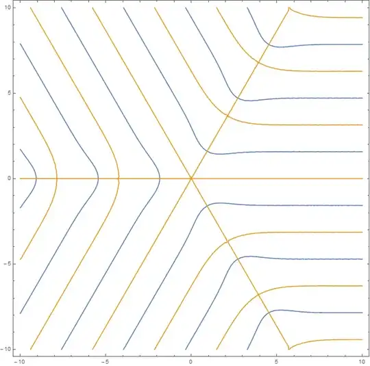

Here is a contour plot showing the roots of $G(x,3)$. The orange curve is $\Im(G(x,3))=0$. The blue curve is $\Re(G(x,3))=0$. The plot shows $-10<\Re(x)<10,-10<\Im(x)<10$. Contour plot
